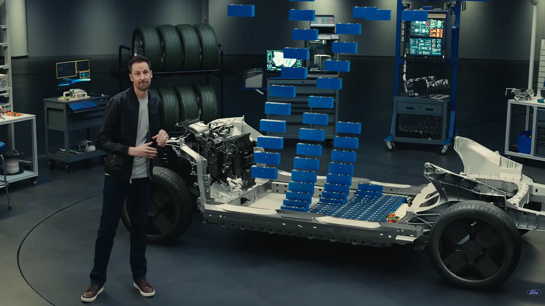

BATTERY SIZE:
The CGI video shows 6 Rows of 16 Battery Cells across = 96 Cells
Possibly there is a 7th Row that gets cut off in the video = 112 Cells
I

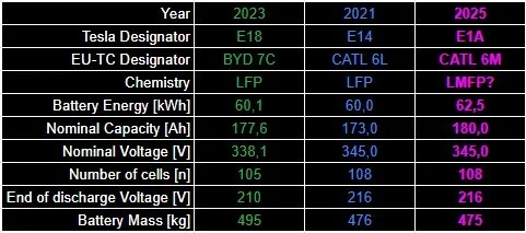

Cell Assumption:
Tesla currently uses CATL's '6M' LFP Cell in the Model 3.
108 Cells
x 180 Ah
x 3.2 Volts
62.5 kWh
Ford is licensing an LFP Cell from CATL.
The general size of a 180 Ah CATL LFP Cell "appears" to be about the right size from the Ford video.
Applying the same CATL specs to what we see in the video from Ford.
96 Cells
x 180 Ah
x 3.2 Volts
55.3 kWh ( 64.5 kWh if there is a 7th Row of Cells not shown in the video)
CONCLUSION:
If this Pickup has a 55-65 kWh Battery some people will blast it as being too small without ever having driven it.
Ford wants to focus on Efficiency, Affordability, and maybe we will get specs on Charging in the next update.
Jim Farley has said over, and over that we need to embrace smaller, more efficient EVs.
Marketing in America keeps telling us we need 300+ Miles or Range and a 100+ kWh Battery.
YOUR THOUGHTS?
Of course, if each cell has MORE than 180Ah each then the math is wrong and the battery is bigger.

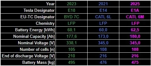

Cell Assumption:
108 Cells
x 180 Ah
x 3.2 Volts
62.5 kWh
96 Cells
x 180 Ah
x 3.2 Volts
CONCLUSION:
YOUR THOUGHTS?
